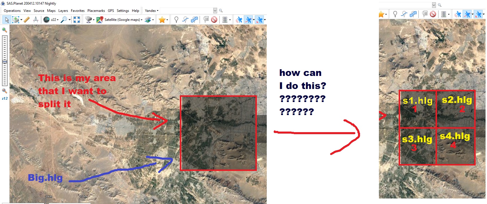

split select area
Сообщение unpointeul » 19 апр 2020, 03:31
hi all.
I need to download large area so i have to split it to 4 smaller areas.
so how can I do it ?

Re: split select area
Сообщение QuickBird » 20 апр 2020, 09:00
unpointeul писал(а):hi all.
Hello and you have to select the area and when "Selection Manager" dialog opens you need to tick the "split selection to parts" and tell how many workers you would like/need/can launch
Sas is defaulted to 4, to change this go to
Settings - Maps Settings - Max concurrent https requests
and set your choice
To this some obvious warning if you launch too many requests servers might throttle you
Google will 429 you for 12 hours, launch UP TO 4 AND ONE JOB FOR UP TO ZOOM 18, then another job for zoom 19, and you will eventually get 429ed at z20, you need to use proxies
Wikimapia 1 request only
or you can try torify your connection with Tallow
for more see the Thread of the Tips viewtopic.php?f=52&t=3350
